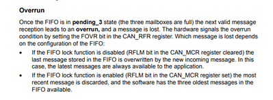

During the B↔C synchronization, B intermittently misses some frames from A (i.e., A transmits, but B does not process/see a corresponding message).
The failure is not immediate: A↔B + B↔C run together fine for a while (sometimes short, sometimes long), then a frame from A is skipped.

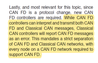

As you can see from the inserted can config the sampling point for 3 devices is at 87.5%. Bitrate is 500000 bps for three of them.

hfdcan1.Init.FrameFormat = FDCAN_FRAME_FD_NO_BRS;

Device B. I use two Fifos:
Fifo0: messages from A
Fifo1: messages from C
void HAL_CAN_RxFifo0FullCallback(CAN_HandleTypeDef *hcan)
while (HAL_CAN_GetRxFifoFillLevel(hcan, CAN_RX_FIFO0) > 0) {
CAN_RxHeaderTypeDef hdr;
uint8_t d[8];
if (HAL_CAN_GetRxMessage(hcan, CAN_RX_FIFO0, &hdr, d) != HAL_OK)
Error_Handler(); // Handle receive error
if (hdr.StdId == Sync_Res) {
syncAckReceived = 1;
rx1_sync_isr_count++;
continue;
uint8_t next = (uint8_t)((RxWrite + 1u) % RXBUFSIZE);
if (next == RxRead) {
// overflow: drop oldest (or set a flag/counter)
g_swDrops++;
continue;
// Use real DLC (0..8) and clear tail
uint8_t dlc = (uint8_t)(hdr.DLC & 0x0Fu);
if (dlc > 8) dlc = 8;
RxBuf[RxWrite].id = hdr.StdId; // you’re using standard IDs
RxBuf[RxWrite].dlc = dlc;
memcpy(RxBuf[RxWrite].data, d, dlc);
if (dlc < 8) {
memset(RxBuf[RxWrite].data + dlc, 0, 8 - dlc);
RxWrite = next;

@RockCoder wrote:
Hi @mƎALLEm ,
FD and Classic cannot coexist on the same pair of wires unless all nodes are FD-capable?
This paper from www.can-cia.org: Hybrid CAN and CAN FD networks , says:

Check also if a FIFO overrun has occurred: FOVR bit is set in the CAN_RFR register:
The behavior depends on if the FIFO Lock is enabled or disabled:

@RockCoder wrote:
Hi @mƎALLEm ,
2025-10-28 6:03 AM
The problem was indeed this. I changed the frame format to CLASSIC frame for all my FD CAN controllers and it solved the problem.
