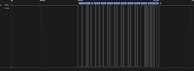

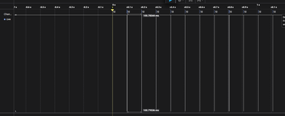

2025-09-23 8:43 AM - edited 2025-09-23 8:51 AM
I tested your project with a little modification and there is no issue. I just connected another CAN node which is a NUCLEO-F767 board (CAN2.0) + a transceiver, and the latter is receiving the CAN frames from STM32H745I-DISCO without issues.
These are the frames send each 100ms:
This screenshot spots one frame:
A screenshot for IAR of the receiving CAN frame (F767 side) showing the Rx content changing in live (only data 0 and data 7 are changing):
Attached the projects that I used for the test.
Now, I'm pretty sure it's not a software issue and you have a hardware issue. Either with the transceiver or the wiring or something else. Maybe you swapped CAN_H and CAN_L? need to check.
Hope that helps.

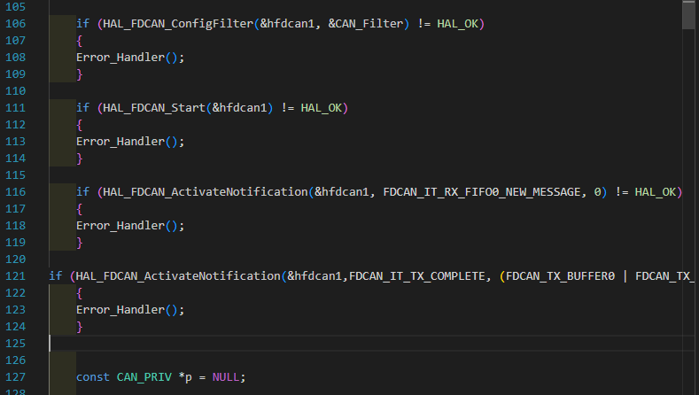

2025-09-16 11:48 PM
After start fdcan, the interrupt should be start

2025-09-18 6:10 AM
I haven’t enabled any interrupts there. Do I still need to mention it?
