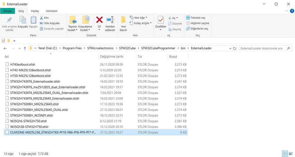

@Tesla DeLorean wrote:Tentative Dual MX25L256 build for your platform (blind port as can't test)
Hi, I download it, its not work. Your .stldr file is only 8kb. My .stldr is 2.274 kb.

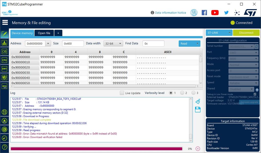

During my tests, 2 of my flashes constantly dropped to 0x99 reading. My guess is that I accidentally enabled write protection. I don't know how to fix this. The chips that stopped reading/writing were both connected to the bk2 data line. I installed both chips that constantly read 0x99 on a card. this is the situation;
2. full chip erase (mass erase) not working in cube programmer.
Thank you very much again for the problem that I have been struggling with for days.
2023-12-27 5:09 AM
Yes, more indicative that they are not responding to commands.
If you have application side code to run and query the QSPI devices individually or paired, perhaps try the READID / RDID without the reset operations. Stick in SPI / 1-bit modes.
The STLDR don't have to be massive. Plus I removed a lot of the debug and symbolic sections.
2023-12-27 2:20 PM
The actual code/data foot-print of yours looks to be around 139KB, still quite massive. The side-effect is that space used by the loader can't be used by the programmer to inter-stage your data to write to the flash, so it does more / smaller transactions on the Write() function.

The chips are actually write protected. I solved the problem by reading a little datasheet and writing a small spi adjustment code.
