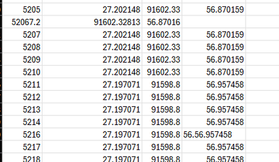

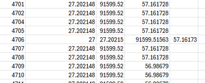

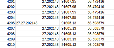

I am working on a data logger project using SDIO with DMA and FreeRTOS. The only sensor currently in use is the BME280, which is working fine. However, I am encountering issues when writing the CSV file, such as glitches, character repetition, and other seemingly random problems.
Here is the relevant code:

No value to using uint16_t, the MCU is 32-bit
You'd need to ensure the serialization of the buffer, so there isn't concurrent interaction of the buffer vs the writing. The writing (read/write) can take 100's of milli-seconds
I'd probably do writing in multiples of the sectors or clusters, and pull-down the overspill.

2024-12-26 4:53 AM
Thank you for the insights, @Tesla DeLorean !
I initially thought that, even with DMA, the write and sync operations in FatFS were blocking—waiting for interrupts to complete before moving on. However, I personally observed that during these operations, the DMA handler is called multiple times, and the SDIO interrupts don’t seem to work as reliably as I expected.
Is there a straightforward way to confirm when write and sync operations are fully completed? Ideally, I’d like to ensure that the data is safely written to the SD card before proceeding, but the current behavior makes it hard to tell if the operation is truly done. Any recommendations on how to manage this or work around it?
Additionally, it would be helpful to have an idea of how long the writing process actually takes. This would allow me to better estimate an appropriate size for the buffer used to receive data, ensuring it aligns well with the write buffer capacity. Do you have any suggestions for a suitable buffer size?

Writing oddly sized blocks to unaligned offset into the file are going to result in a lot of reads and writes to deblock.
The machine has counters and timers, you can measure elapsed time if it's concequential.
Operation over the bus needs to be serialized, are you sure you're not getting errors as a failure in the prior command will block subsequent ones.
I'd be shooting for whole 16 or 32KB blocks depending on available resources. The fill buffer can be independent of the write buffer. You can do them in independent threads but there needs to be a clean hand-off, so things don't change in-flight, and you don't create race conditions.
