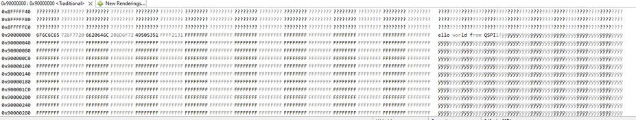

I am trying to use ST's QSPI driver that I found in that github link. https://github.com/STMicroelectronics/stm32-external-loader/tree/contrib/QSPI_Drivers I am using MT25QL512ABB1EW9-0SIT and when I tried to wire memory function that read it with using memorymapped I saw that first byte of my array is missing. When I increment the writing address one the problem is gone but I am trying to understand what can cause this issue.

  if(CSP_QSPI_WriteMemory(writebuf, 0, strlen(writebuf)) != HAL_OK){ //It is starting to write from that wanted address -1 please check that

  memcpy(readbuf1, (uint8_t *)0x90000000, sizeof(readbuf1));
  memcpy(readbuf2, (uint8_t *)0x90020400, sizeof(readbuf2));

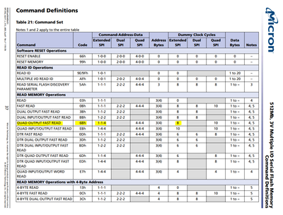

KDJEM.1
Hello @Aurentiaco ,
In the driver code "quadspi.c", specifically in the the function "CSP_QSPI_EnableMemoryMappedMode(void)", the command-address-data is set to 1-1-4 which is for extended SPI, and dummy cycle set for 10, which is intended for Quad SPI mode as mentioned in the memory datasheet. However, according to the datasheet, dummy cycle configuration for extended SPI should be 8. Therefore, I suggest changing the "DUMMY_CLOCK_CYCLES_READ_QUAD" to 8 in the "quadspi.h" and see if the issue persists.
Please let me know if the issue is solved or not?

I don't see where the instruction is written into sCommand structure. I'd also recommend clearing it on the stack so it doesn't continue any junk values.
Check the dummy cycles match those that are defined or configured in the device.
These cycles are used to prefect content from the array so they can be streamed back to you.
For data arriving late check dummy cycles or 3 or 4 byte address mode settings
That works thank you so much for your help.
