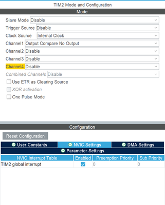

I've used TIM2 to count to 100000 every second. With this i hope to make a very accurate millisecond timer. I can see the counter succesfully going to 1s and then i reset it manually using the RTC interrupt.
Now i want to use an output compare with no output to trigger an interrupt. But i can't do it. Please someone help me.

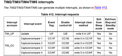

Sorry, ...so you cannot use TIM1 or 8 ?
If it has to be tim2 : check, it calls TIM2_IRQ at all ?
+ check flags:

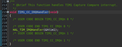

2023-12-26 6:01 AM
did you enable the compare INT at all ?
(here enabled ! )
then you get it in xx_it.c

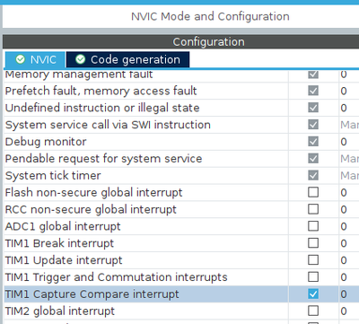

2023-12-26 6:23 AM
Hey thanks for responding.
Yes i did, but for this advanced timer there is only a global interrupt.
