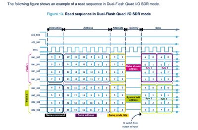

Thank you for nice tips Tesla DeLorean. I tried to edit to code as you said. But still can't write to 16 mb above to 2nd flash. I think the second flash does not switch to 4 byte (32 bit) adress mode.

}AN4760 only show quad line read squenze to dual flash. How to 1 line write squenze to instruction code data write?

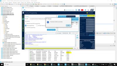

@Tesla DeLorean thank you for your solutions!! :) now work fine
Yes, stlink V3 is the bottleneck when writing flash. Its takes about 15-20 minutes when 64 mb flash writing.
But, dual qspi MemoryMappedMode better than single flash. I can run to tgfx animated picture on the 1024 x 600 pixel lcd without any flicker or frezing. H7 series mcu most performing one. If there were no 256 mbyte limit, I would like to try two 1 gbit nor flash (with a little writing patience and more coffee breaks)
