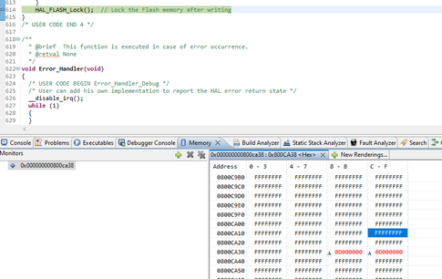

I can see in the Memory, that the write was succesfull:
After the HAL_Flash_Lock(); returns, the program goes into hardfault exception interrupt, the strangest thing is, that it does not happen at the same time between tries. Sometimes it goes right into hardfault, sometimes it executes some instruction, and then goes into hardfault.

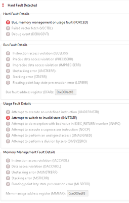

The Fault analizer states this:

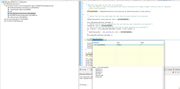

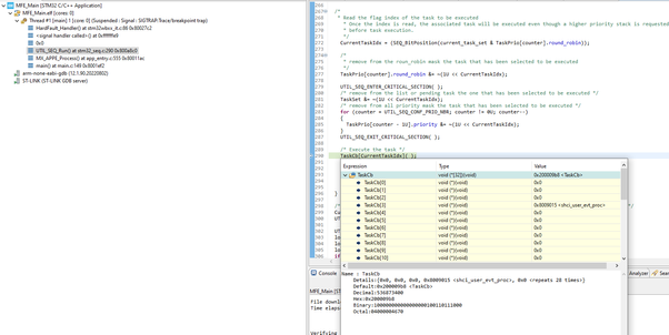

2024-09-18 5:57 AM
I finally was able to detecte where is the Haurdfault comed from:
After writing, the main loop calls MX_APPE_Process(); the tries to start a task, but the index is pointing to a place where there is no task:
After calling that, the program goes to HardFault
