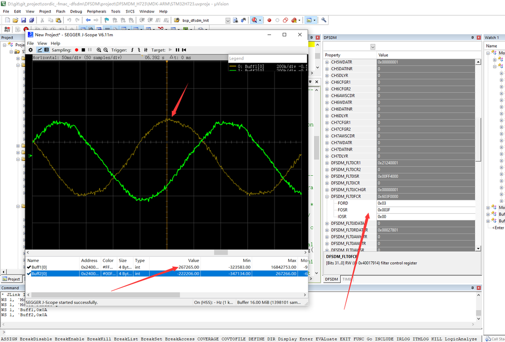

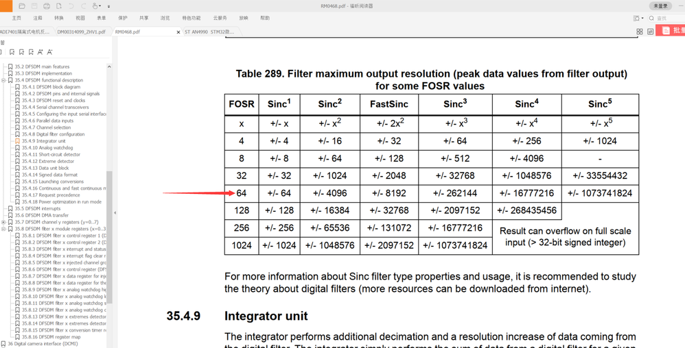

When I use DFSDM, I configure FOSR= 256 ISOR=1 and the output is outside the range in the reference guide +-16777216

Get the answer
/* Regular conversion value is a signed value located on 24 MSB of register */
/* So after applying a mask on these bits we have to perform a division by 256 (2 raised to the power of 8) */

Can you verify the range of DFSDM output results at FORD=3 FOSR=256 ISOR=1 ?

2023-03-02 4:35 AM
Get the answer
