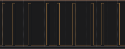

I want to generate an arbitrary waveform by a timer using DMA. The waveform is using different pulse widths and also varying periods in multiples of 25µs.
By reading AN4776 and HAL documentation I figured out it should be possible with HAL_TIM_DMABurst_MultiWriteStart() function. Unfortunately I don't get an output signal except after reset where a short pulse can be seen. I assume this pulse is due to port configuration during initialization. After that pulse, the signal stays high.
My setup (CubeMX):
For a first run I want to use fixed pulse widths and varying periods, so all my code does is the following:
/* USER CODE BEGIN 2 */
htim16.Instance->ARR = 39; //40 * 5µs = 200µs period
htim16.Instance->CCR1 = 4; //5 * 5µs = 25µs pulse
HAL_TIM_DMABurst_MultiWriteStart(&htim16, TIM_DMABASE_ARR, TIM_DMA_UPDATE, (uint32_t *) Buffer, TIM_DMABURSTLENGTH_1TRANSFER, sizeof(Buffer) / sizeof(Buffer[0]));
HAL_TIM_PWM_Start(&htim16, TIM_CHANNEL_1);
/* USER CODE END 2 */As far as I understood I need to initiate the first pulse by calling HAL_TIM_PWM_Start() and HAL_TIM_DMABurst_MultiWriteStart() setup the DMA to handle the subsequent transfers.
When running that code, I get a single pulse of ~3.4µs at a period of 5.8µs, after that the output stays high. Since this is my first encounter with DMA I'm a bit lost. I don't get what I'm missing because other forum entries use basically the same approach as far as I can see.

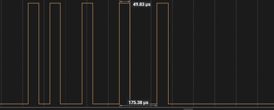

2026-05-05 8:26 AM
Hello @RAltm
>However, I indeed want to use non-circular mode. I want to output a varying number of pulses with varying period and pulse duration. Between the pulse trains, the output should stay low and the next pulse train must not start before the period of the last pulse of the previous train has expired
This task can be challenging if you want to achieve clean results.
Using DMA in normal mode typically generates a continuous PWM signal, with the last value in the pulse train remaining at the ARR. To generate a second pulse train, you must stop the PWM and restart it.
You can apply the following modifications to the previous project to address this use case:
The configuration creates a pulse train with values of 100, 150, and 175, then stops (with the PWM signal held low) until you start the timer with a new pulse train.

You should get a result like this :
BR
Gyessine
