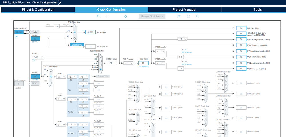

Thank you all ! I appreciate all your suggestions. The consumption has significantly decreased frome 7mA to 250uA.
But I'm still puzzled by this value that differs from what is indicated in the datasheet. Do you notice anything else that might be causing this issue?
Here's my clock configuration:
and this is my code snippet:

2024-02-21 1:16 AM
@SD0509 wrote:I'm still puzzled by this value that differs from what is indicated in the datasheet.
Again, the datasheet covers just the chip itself - it cannot take anything outside the chip into account.
It also knows nothing of your application.

2024-02-21 8:34 AM
At the project's creation, I didn't initialize the pins to their default mode. Moreover, I've disabled all AHB1, AHB2, APB1, and APB2 peripheral clocks, yet the power consumption remains unchanged.
2024-02-21 8:43 AM
Back to this post:
are you sure you've isolated everything to be sure that what you're measuring in just the STM32L4R5 and nothing else?
