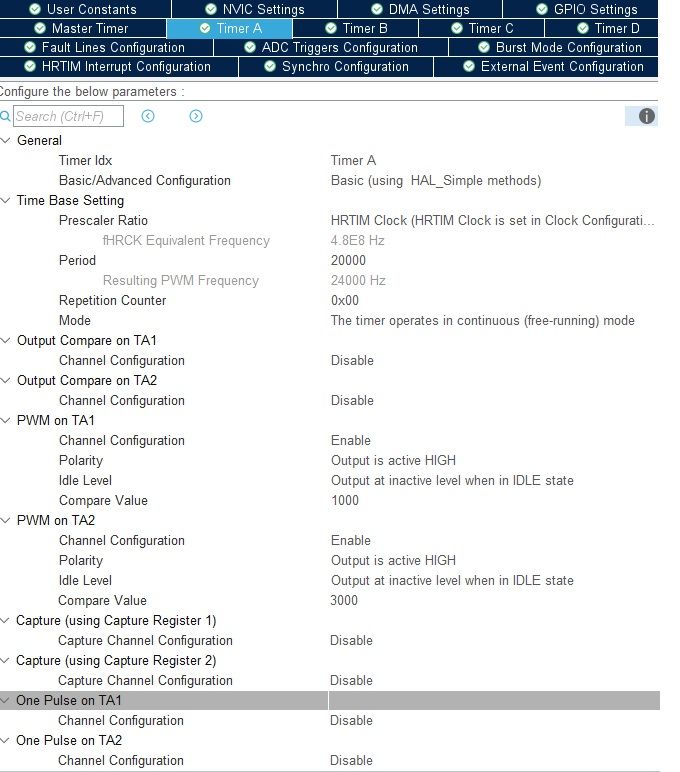

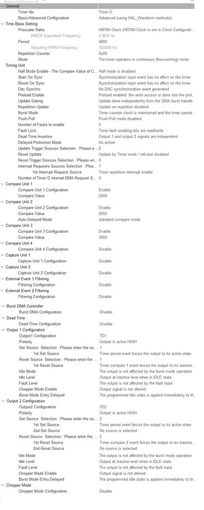

TIMER-D configuration:
TIMER-A configuration:

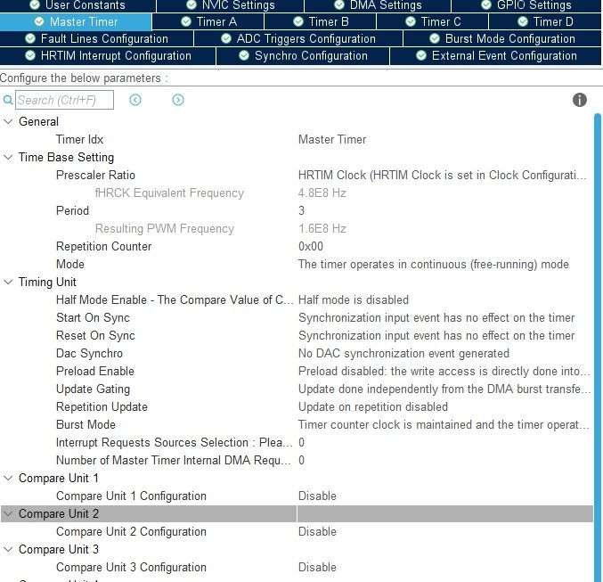

MASTER TIMER CONFIGURATION:
2024-02-21 7:42 AM
After making this:
HAL_HRTIM_WaveformOutputStart(&hhrtim1, HRTIM_OUTPUT_TA1);
HAL_HRTIM_WaveformOutputStart(&hhrtim1, HRTIM_OUTPUT_TA2);
HAL_HRTIM_WaveformCounterStart(&hhrtim1, HRTIM_TIMERID_TIMER_A) ;
HAL_HRTIM_WaveformSetOutputLevel(&hhrtim1,
HRTIM_TIMERINDEX_TIMER_A,
HRTIM_OUTPUT_TA1,
HRTIM_OUTPUTLEVEL_ACTIVE);
HRTIM_OUTPUT_TA2,
HRTIM_OUTPUTLEVEL_ACTIVE);Worked the Timer A1 but not the A2, that is due Weact board uses the HRTIM legs to connect to USB ,camera, display. I recommend build a custom board.
