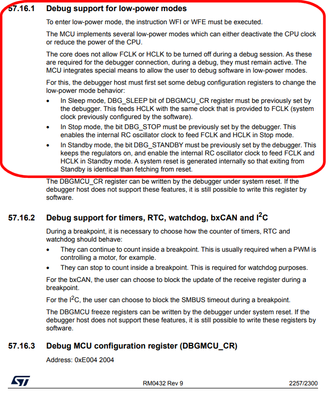

2024-02-15 9:06 AM - edited 2024-02-15 9:13 AM
@SD0509 wrote:I have enabled the debug in low power modes.
Then the low power modes are not really low power at all!
@SD0509 wrote:But that doesn't justify a power consumption of 7mA in stop modes
Oh yes it does - It explains it entirely!
Addendum - from the Reference Manual:
