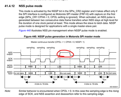

Typically that's done with a separate chip select (CS) line. You can use NSS Pulse mode to have the CS line go high between words, if that's what you need.

Seems okay to me, except there's a lot of cross-talk/bounce. You're only showing about 8 bits worth of data, so could just be missing where the pulse is. Did you enable NSS Pulse mode? Can you show your code?
