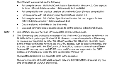

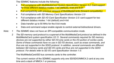

To check if the memory is supported by the SDMMC you need to verify that the memory is supported by the MultiMediaCard System Specification Standard.
For example according the STM32F765 reference manual; the SDMMC in this STM32 complies with MultiMediaCard System Specification Version 4.2.

According to the reference manual,  the version of the SDMMC supports in STM32F765 only one SD/SDIO/MMC4.2 card at any one time and a stack of MMC4.1 or previous.
Thank you.
