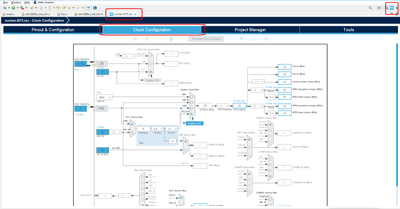

2024-01-30 1:58 AM
Also look at the graphical representation in the STM32CubeIDE Device Configuration Tool - it shows you all the clock sources, routing, etc.
This is a different chip, but shows the idea:
