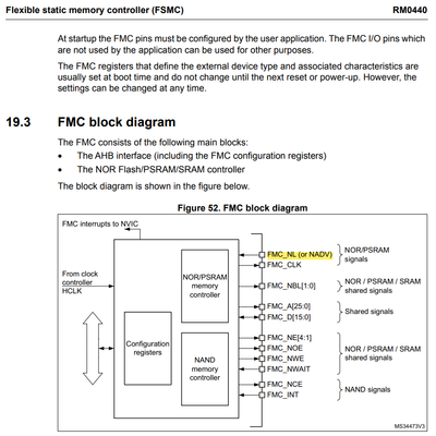

Hello @wb0gaz
It is already mentioned in the reference manual figure 52. FMC_NL (or NADV)
I agree, it should have been explicitly detailed in the datasheet.
