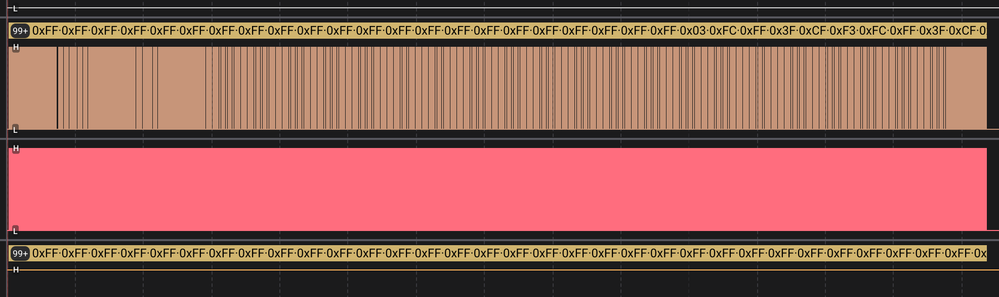

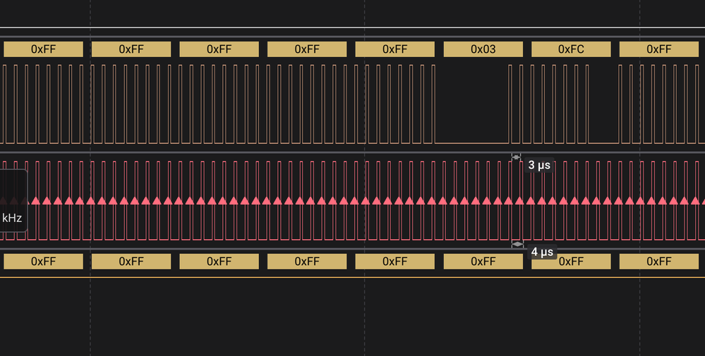

In the end this is the output on the logic Analyser:
Full 402 Data Chunk
