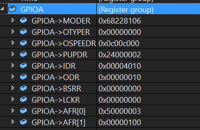

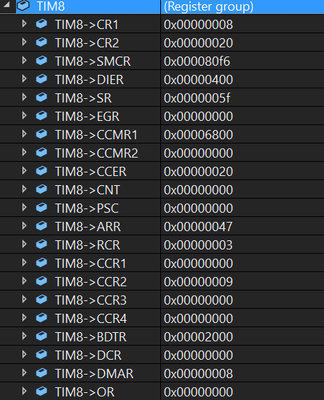

Here are my register values:
Any leads on this would be of help.

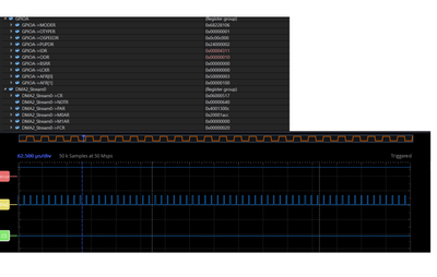

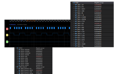

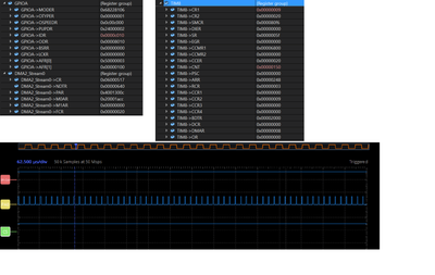

I have attached some Screenshots of waveform with the register values. There are three stages:
1) Before CS Low
2) CS Low without DMA trigger
3) CS Low and DMA trigger
Stage 3 is when the PA0 signals are getting corrupted.
