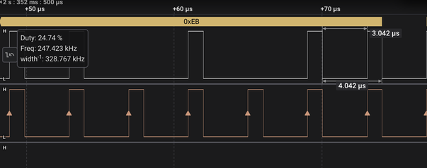

When using a Logic analyser with 24 MHz freq, I can see shift of signal by 1 or 2 cpu cycles and so delay.

- Screenshot of the logic analyzer

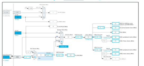

Clock configuration

Even something as “lowly” as stm32f1 does not guarantee cycle-by-cycle timing accuracy. Where there are things like FLASH accelarators and multiple clocks in a system, precise timing becomes unpredictable, particularly if you have other things going on such as DMA or interrupts.
(I think stm32f0 data sheets, in contrast, do mention cycle-by-cycle predictability).
You could reduce the number of things “going on” by putting your delay code inline rather than as a subroutine call - this will avoid delay-unpredictability associated with the jump and push/pull of PC to/from the stack.
How certain are you of the delay error? Are you using a Is it consistent or only on some cycles? I see you are using HSE but is it a crystal or a lower-accuracy ceramic resonator?
