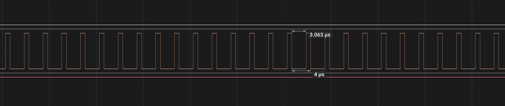

I am porting an old application made on AVR to STM32, and I am facing a strange timing issue.
In a nutshell, the application is reading sector (512 Bytes) from a SDCARD and output the content of the buffer to GPIO with 4us cycle (meaning 3us low, 1 us data signal).
The SDCard read is working fine, and I have written a small assembly code to output GPIO signal with precise MCU cycle counting.
Using DWT on the debugger, it give a very stable and precise counting (288 cycles for a total of 4us).
When using a Logic analyser with 24 MHz freq, I can see shift of signal by 1 or 2 cpu cycles and so delay.
I have tried to use ODR directly and BSRR but with no luck.
Attached :
- Screenshot of the logic analyzer
Clock configuration
Port configuration:
I do not know where to look at to be honnest

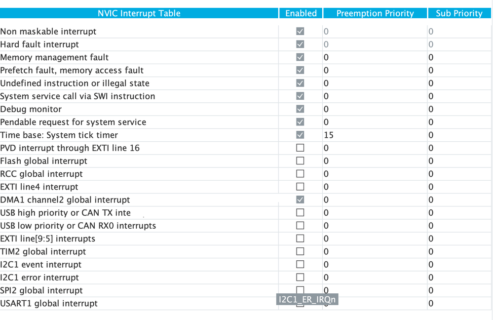

2024-05-13 5:09 AM
This is the view NVIC in CubeMX,
Does it change something to uncheck these ?

2024-05-13 1:30 PM - edited 2024-05-13 1:35 PM
I don't see any glitches in your screenshot.
Timing also looks good. The imperfections be an issue with synchronization between the logic analyzer and the microcontroller. Try a logic analyzer with a higher clock and you might see even better timing. Clock dither of the MCU and/or the logic analyzer can also be a factor. Rise time can also be a factor in imperfect measuring of pulse widths.
You say your logic analyzer is clocked at 24MHz, but that would make 3.063us about 73.512 clock cycles of your logic analyzer (or exactly 73.5 cycles and the 3.063 is a rounded number). So that cannot be correct. Does it sample at both edges of the clock? So 48 MSamples/second?
2024-05-13 9:27 PM
I have done sampling at different logic analyser speed rate and the pulse timing is not right. I have a comparison with an ATMEGA328P.
The issue is that I have 402 bytes per data stream to be sent, it means 402*8*4 us period = 12 864 us for a data sector.
When I have 0.063 us shift time to time, I can have more than 1 bit or 2 shift in the end and data corruption with the 2 byte XOR CRC send at the end of the transfer.

2024-05-14 2:03 AM
Use logic analyzer or oscilloscope with much higher sampling frequency then your MCU frequency or you will not be able to distinguish measurment relics from real MCU output jitter. Imagine that you generating perfect square wave with frequency 72MHz/20=7.2MHz (period 277.8ns). If you sample this signal by analyzer with 24MHz (period 41.67ns) the you will see jittering output of 2 consecutive periods in duration 6*41.67 (250ns) and one period in duration 7*41.67 (292ns) - on perfect square wave ! And that can leads you to wrong conclusion that jitter comes from MCU output ...
2024-05-14 2:07 AM
Hello Michal,
Thanks and I genuinely agree with you. However it is not easy to find an AL with capability above 24 MHz.
what I do is to look at the data stream over the whole transmission period and I should not get significant delay. Unfortunately I have delay and not a 250kHz fdata freq.
Vincent
2024-05-14 3:32 AM
Ordinary oscilloscope should be able to handle it with ease. As others have already written - use SPI or USART or Timer + DMA and you will get easy seamless pulse stream and with minimal CPU load.
