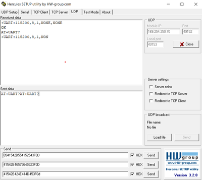

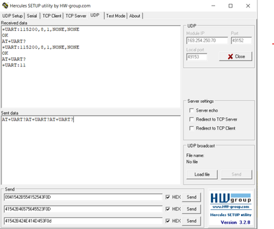

2025-01-22 3:20 AM
Hi @Andrew Neil ,
Can you explain this behaviour that my UART4 and UART7 are not works together any specific reason?
If I use Ethernet instead of UART4 to send/receive cmd i am able to get UART7 interrupt.
Here is my code for your reference,
// Callback function to handle received data from Ethernet
void handle_received_data(uint8_t *data, uint16_t size)
// Transmit the string data over UART7
HAL_UART_Transmit(&huart7, data, size, HAL_MAX_DELAY);
// Recived data over UART7
void HAL_UART_RxCpltCallback(UART_HandleTypeDef *huart)
if (huart->Instance == huart7.Instance)
// send Recived response to to Ethernet
udp_send_uart7_data(rxBuffer7,sizeof(rxBuffer7));
memset(rxBuffer7, 0, RX_BUFFER_SIZE_7);
// Ready to get new data
HAL_UART_Receive_IT(&huart7, rxBuffer7, RX_BUFFER_SIZE_7);
This code works as expected but somehow my response comes incomplete after sending AT cmd.
Like this ,
When I send the command AT+UART? for the first time, I receive the complete response. However, when I send the same command AT+UART? again, I only receive a partial response. On the third attempt, I receive the complete response of the second command, while the response for the third command remains incomplete."
Can you explain why this behavior is occurring and suggest a solution to fix it

@Mehulrana511 wrote:This code works as expected but somehow my response comes incomplete after sending AT cmd.
So it is not working as expected!
In this case, have you monitored the hardware connection between UART7 and the WIFI/BLE module, and confirmed that everything on the wire is still correct.
@Mehulrana511 wrote:When I send the command AT+UART? for the first time, I receive the complete response. However, when I send the same command AT+UART? again, I only receive a partial response. On the third attempt, I receive the complete response of the second command, while the response for the third command remains incomplete
That could be your AT Command handler getting out-of-sync?
In that case, pay particular attention to your handling of CR and LF ...
Are you properly handling the command-response sequence, or are you just relying on arbitrary, "blind" delays?
PS:
This doesn't look good:
}With that, the UART receive will only compete when it has received exactly RX_BUFFER_SIZE_7 characters.
But your replies from the BLE/WiFi module are of different sizes - they are not RX_BUFFER_SIZE_7 characters long.
So you will be receiving partial messages, and/or (parts of) multiple messages at each interrupt.
Again, see the comments on ring buffers.
