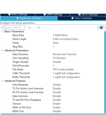

I am using USART4 in STM32L562E-DK eval board. with given configuration.
In which I am able to transmit the data correctly on TX based on which UART slave device is sending back the 4 bytes ACK and 16 bytes RESPONSE.

2025-09-09 8:59 PM

2025-09-10 7:19 AM
> Will I need to clear OVR flag manually after reading 4 bytes.
Are more bytes coming in which you aren't ready for?
HAL_BUSY indicates the peripheral is already waiting for data. You shouldn't be calling HAL_UART_Receive_IT more than once until it finishes.
2025-09-10 11:29 AM
If the slave is sending in packets, then use HAL_UARTEx_ReceiveToIdle_DMA and HAL_UARTEx_RxEventCallback for idle event.
On each packet sent, there will be an idle state which will interrupt. By using a queue, you can separate each packet in it's own queue for easing processing. If you don't want to use DMA, you can use HAL_UARTEx_ReceiveToIdle_IT without DMA.
See this example project https://github.com/karlyamashita/Nucleo-G071RB_UART_DMA_Idle_Circular/wiki
