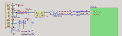

USB_P is connected to PA12
USB_N is connected to PA11

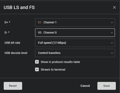

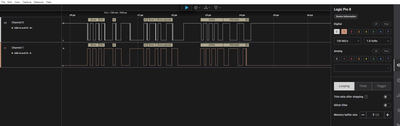

Since this is my first time dealing with USB, I have decided to hook up my Saleae logic analyzer to usb D+ and D- pins to inspect how it works and what it sends.
This is my Analyzer configuration:

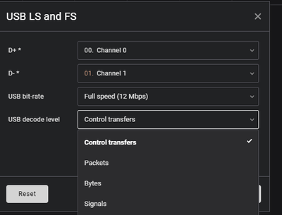

But I am very confused about USB decode level, what should I choose?

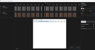

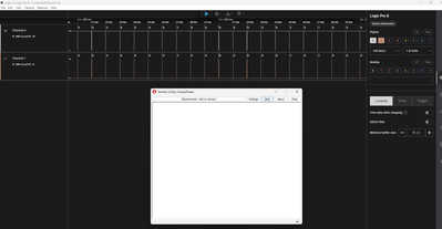

And I notice things I did not expect to see. When I have the virtual com port disabled (not connected), I see the following:
If I zoom in, I see the following:
As soon as I open the com port, I see the following:
If I zoom in, it looks as following:

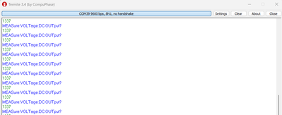

When I try to send data via com port, I get the expected response:
MEASure:VOLTage:DC:OUTput?
1337
1337
1337
1337
1337
But I cannot make anything out from the D- and D+ lines when sending/receiving.
I want to understand whether this behaviour is normal.
2025-08-13 7:45 AM
Hi @LPetr.1
It's complicated to follow USB signaling and protocol analysis at the physical layer ! Using USB sniffer or analyzer is way practical to understand USB traffic. You need to Learn USB fundamentals, focus on understanding USB device states, enumeration, endpoints, and class protocols (like CDC for virtual COM ports) before diving into electrical signaling details.
2025-08-13 8:19 AM
That makes sense, but for the time being, I just need to understand whether that is something I should worry and that indicates some real USB problem or that is normal behaviour for USB?
I am quite confusef about all those packets coming thriugh for no reason, but at the same time I am happy that I seem to be able to send commands and receive valid responses via the USB cdc virtual port, so that must be a good sign.
Additionally, perhaps you can recommend some USB debugging tools that I can use to further analyze my USB behaviour and additionally perhaps some usb reading material to get me started about this protocol and not overwhelm me with unnecessary complicated information. Anyway, thanks for your response :)
