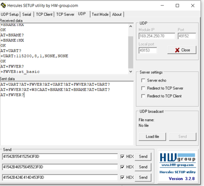

2025-01-21 4:19 AM - edited 2025-01-21 4:23 AM
Hi @Andrew Neil ,
Thanks for answering but I need UART4 for debugging purpose.
One thing I need to add in this thread,
When I was trying HAL_UART_Receive_IT function and send cmd from Ethernet, I get response from UART7 but it happens only once(at very first time) then i am not able to get response even after sending same or different cmd.
But when I use HAL_UARTEx_ReceiveToIdle_IT , I am not able to get response even single time.
Here is the screenshot of response i get from UART7 when i send cmd from UART7.
/Mehul

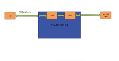

2025-01-21 5:27 AM
I am using the STM32H7S78 microcontroller and the MXCHIP EMC3080-P WiFi/BLE module.
In my setup:
UART4 and UART7 are enabled on the STM32H7S78.
The flow of data is as follows:
Here I attached rough diagram for understanding.
/Mehul
2025-01-21 5:33 AM
Right - now that's clear.
That's a very long chain of operations - you need to check at each point to see where it's breaking.
Have you monitored the lines between UART7 and the MX-Chip to see what's actually being sent and received?

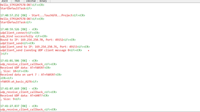

2025-01-21 5:53 AM
However, when i comment the UART4 init function and and use Ethernet instead of UART4 to send / receive cmd its work successfully.
But i am not able to see other logs on Docklight as i disabled UART4.
Here is screen shot,
Can you explain this behaviour? Additionally, please suggest how to make it work while keeping UART4 enabled.
/Mehul
