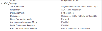

I found two settings that were incorrect:
"DMA continuous conversions" should be Enabled (don't know how I missed that) and "End of Conversion Selection" should be "End of sequence of conversion".
With those settings I managed to get a continuously ADC, though I saw one of the channels produce only zeros. But that might have been an unrelated issue.

Really? The pictures are in high resolution and I can read them fine. You'd have to open the file in the browser and click the zoom button or download the bitmaps first and use a local viewer. Direct links:

@gbm wrote:It will probably be useful to use continuous ADC conversion with DMA in circular mode. STM32 doesn't like it's ADC to be stopped for more than 0.5..1 ms.
DMA is already in circular mode, visible in the screenshot.
