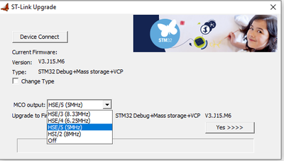

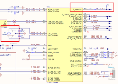

It depends on what stlink is outputting. STLINK itself could generate MCO output from its internal clock source or from its external crystal. So you need to use STSW-LINK007 tool to set the MCO output source. You need to set an integer value for HSE to find suitable velues when you set prescalers later on.
According to NUCLEO-U545RE-Q schematics STLINK module is clocked by a 24MHz.
Unfortunately I don't have that board to test but as stated before you need to configure STLINK MCO to output a clock generated from its HSE.
So, the MCO isn't an issue. I was able to get the U545 running with the MCO output at 8MHz.
However, running the U545 from the MCO does not solve the issue.
