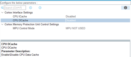

I do not use MPU.

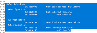

And before writing those lines in the linker script, I also got an address in this register which was 0x341c0098 (most certainly generated by STM32CUBEMX). I also found .RxDecripSection in RMII_PTP.v0_FSBL.map and the address was 0x341c0098.

And as I said I didn't enable MPU, or any caches:

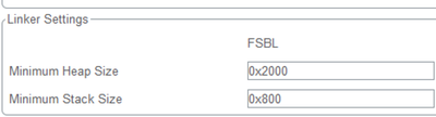

Maybe the Heap Size is to short (I choose a bit more than 4*Rx Buffer Size)?

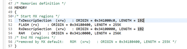

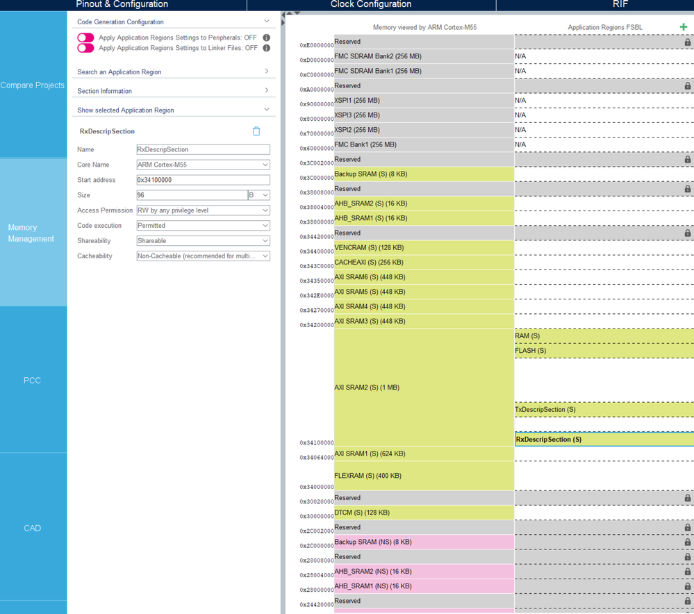

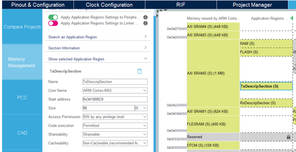

2026-04-21 8:39 AM
Hello @STackPointer64,
I have made some corrections concerning the attribution of the address for the descriptors, now I can see them in my linker script.
(.RxDescripSection and .TxDescripSection are also defined under SECTIONS)
Nevertheless it came to another issue, I had to double the length of both descriptor, from 96 to 192. I don't understand why the size isn't enough. The size of a section is 96 and the descriptor length is 4.
That are the default values actually. When I set the size to 192 in STM32CUBEMX in the Memory Management it changes te descriptor length to 8.
