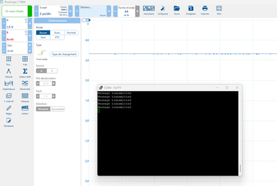

So , i am facing a problem to display the frame i am supposed to send from CAN_Tx pin in loopback mode. I am using picoscope to display.
Here is the function i wrote to configure the Header, and send the data:

In the Main function, i am calling it after the HAL_CAN_Start function. The uart connexion tells me that the frame is sent but i can't see it though.
Thank you again for your precious help!

Nothing changed:
Let me inform you than i got it to work once but several weeks ago and when i added some structures and other functions in order to fit it into a real project then it couldn't work anymore. And the parameters you asked me to change were the same unfortunately.
2024-03-25 7:57 AM
Wait Wait! It works actually.
The debug mode does not allow us to see a frame. Only run mode. Thank you for your help!

2024-03-25 8:23 AM
2024-03-25 8:34 AM - edited 2024-03-26 12:37 AM
Have a nice day!
Nice! You're welcome :smiling_face_with_smiling_eyes: .. But still strange it could not be running in debug mode!
Which Toolchain are you using? I will try it with a NUCLEO-F446RE board when I have one on hands.
