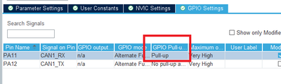

Configure CAN_Rx pin (PA11) in pullup mode:

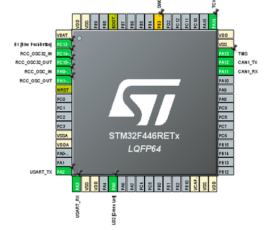

Thank you for your quick answer!
Here is the GPIO config from the .ioc
2024-03-25 7:09 AM
Thank you for your help. I don,t know how come this worked but it did.
