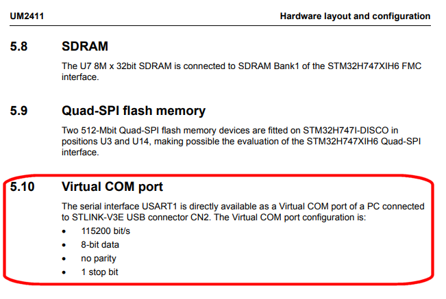

CN2 is also the debugger port which will be connected to my Mac, it wouldn’t be able to have two simultaneous connections hence I had tried using the USB OTG port initially which was connected to the PC.
2024-03-25 8:53 AM

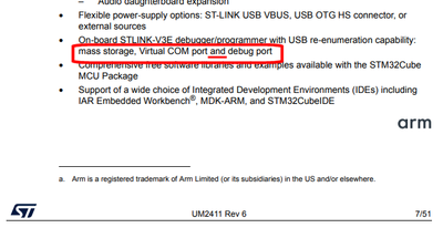

No need to have two connections.
ST-LINK can handle the debug and the virtual comport at the same time.
2024-03-25 9:04 AM
@mƎALLEm wrote:No need to have two connections.
Indeed - and the Mass Storage!
