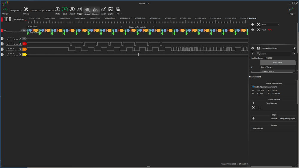

This problematic sequence only occurs once and can be reproduced. The ONLY time (even for hours) the SCE interrupt occurs is at this event.
My oscilloscope is a 40 years old analog 35mHz type without memory function - this won't help i guess.
But you see in the detailed diagram that the boinks are well aligned before the "problematic sequence" and communication resumes after the re-transmission stopped.

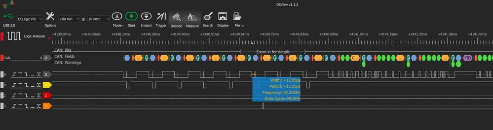

But the frame has just begun when the "boinks" are interfering transmission. An ACK signal is 2uS long but these 8 boinks are 12uS and ALWAYS 8 successive ! And how can the CAN controller detect a frame error when it does not even allow transmission of the frame and interferes 12 uSecs after dominate signal ?

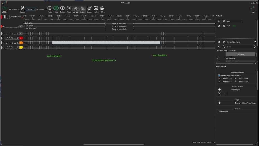

btw: this is when the situation recovers after hundreds of ignored frames the other side changes the frame and this is then accepted.
The "big picture" so when the problem starts (see waveforms) anf how it recovers after ~15seconds.

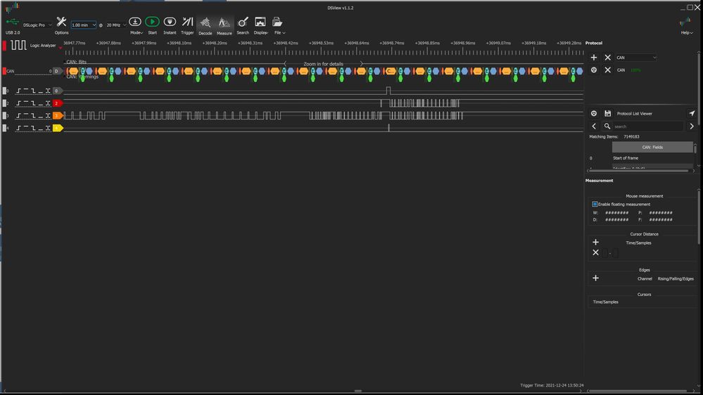

Setting the SILM bit in the SCE ISR does not prevent the additional 2 boinks after the six before.
2021-12-24 5:32 AM
Seems I have to live with this and accept it as part of the startup sequence. I hope the CAN bus in vehicles uses different baudrates/frames and boinks :)

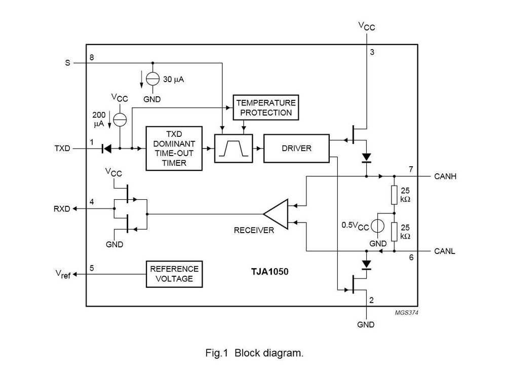

I think the open drain does not make a difference as the CAN chip uses Push pull output circuitry:
