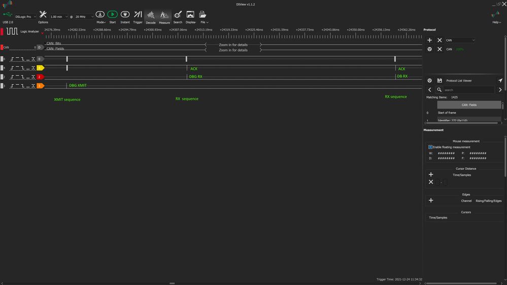

2021-12-24 2:19 AM
I think That Tx blimp you see is the canbus peripheral ACKing the received message.
Or it could be noise, anyway, using the analog readings (osilloscope) will give you a lot more info about what is going on.

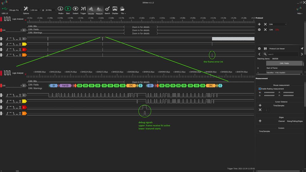

2021-12-24 2:52 AM
Hello Javier,
These boinks would be very misaligned and way too fast if you consider the first 8 of them.
Seems the CAN controller lost sync and the retransmitted frames (in the above example) are maybe ACKED but the according frames not received.
After six boinks the STM32 seems to recognize the problem (it caused by itself) and raises frame warning/error interrupt (see the circle).
But it is unfortunately not able to resync the bitstream. Only when the sender stops successive retransmission communication continues and stays stable for hours then.

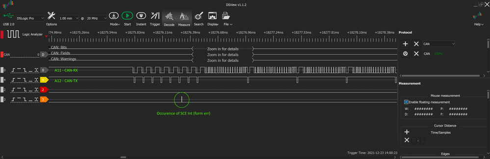

This is the picture of regular frames and the point when things screw up.

@Javier Muñoz ,
From the picture of his first post, a Form Error interrupt is raised. So the issue comes from the frame structure itself.. That's why I'm suspecting a hardware issue.
