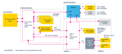

0x34200000 is in an NPU-associated SRAM bank, so the HOST CPU/debugger may not be able to read it unless that region is explicitly configured as shared and accessible. The fact that ISP_Init() and HAL_DCMIPP_CSI_PIPE_Start() succeed does not guarantee that direct CPU access to the buffer is valid. In your recreated project, the most likely issue is a mismatch in memory configuration compared with the original example especially the linker script, MPU setup, and cache/shared-memory settings. The safest test is to place BUFFER_ADDRESS in a known CPU-accessible RAM region first; if that works, then the problem is definitely the AXISRAM/NPU memory configuration rather than DCMIPP itself.
You can see these memories in this block diagram:
You can find out more about the NPU memory subsystem in this link.
