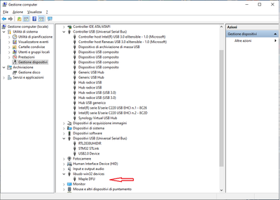

And STLINK isn't even displayed, at most I see a Maple_003 port which I tried to use but without success.
Where am I doing wrong ?

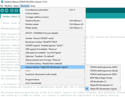

2023-10-17 12:37 PM
So what's the STM32CubeProgrammer (SWD) option?
2023-10-17 8:25 PM
Wow !!!
Many thanks "Tesla DeLorean", now I can program it, but is there no way to have a serial port to check its operation?

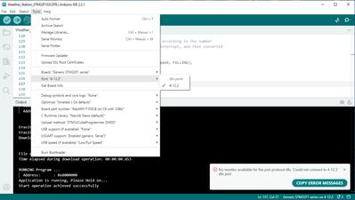

2023-10-17 8:59 PM
Now the situation is this, I can program the board but I don't have the possibility to use the monitor for debugging.
Are there any solutions?

ok, if st-link is connected for program/flash,
and then the program makes VCP over USB, you need to connect extra cable from PC to mini/micro-USB plug.
2023-10-18 9:04 AM
Yes, it is connected to my PC end mini USB
