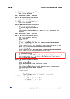

This may be an inherent limitation.
The counter in encoder mode counts upon both edges, but the interrupts on both edges are disabled:
One way to work around this could be feeding *externally* the signals also to channels 3 and 4 of the same timer, and setting up the interrupt on both edges.

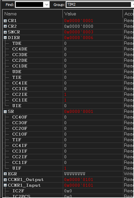

I suspect it's at hardware level, because....
The interrupt flags are both enable and the the interrupt handler has code for each channel and call the same HAL_TIM_IC_CaptureCallback(htim) function.
