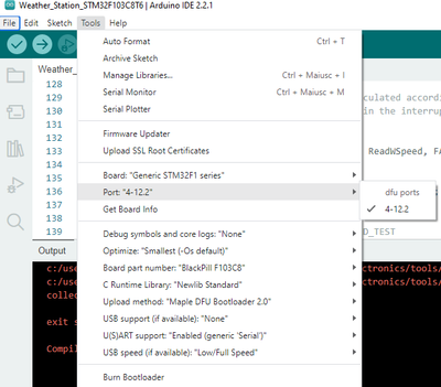

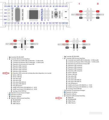

2023-10-16 11:43 PM
Many thanks everyone for your suggestions.
So, this is the situation after trying to install both the maple_mini_boot20 and generic_boot20_pc13 bootloaders, both with the BOOT0 jumper set to 1
I have never programmed a board with the STM32CubeProgrammer, I only saw online how to install the bootloader.
In the condition where the Maple 003 port is displayed on the Arduino IDE, the dfu 4-12.2 port appears but even using that I cannot program the board.
Is it possible to program it using the STM32CubeProgrammer?
Is there a guide to do this?
