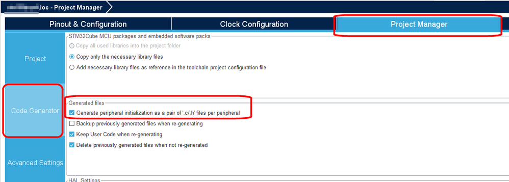

@Andrew Neil wrote:You could use a separate CubeMX project to generate the GPIO config - then just copy that code into your "main" project with the I2C.
This is probably easier if you use the option to generate separate .c & .h files:
#GenerateCandH #SeparateCandH

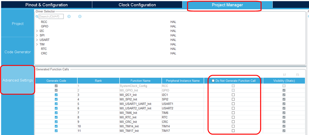

@Andrew Neil wrote:You can configure CubeMX to have it not generate calls to some or all of its generated initialisation functions
Here:
#DisableInitCalls #DisableInitialisationCalls
