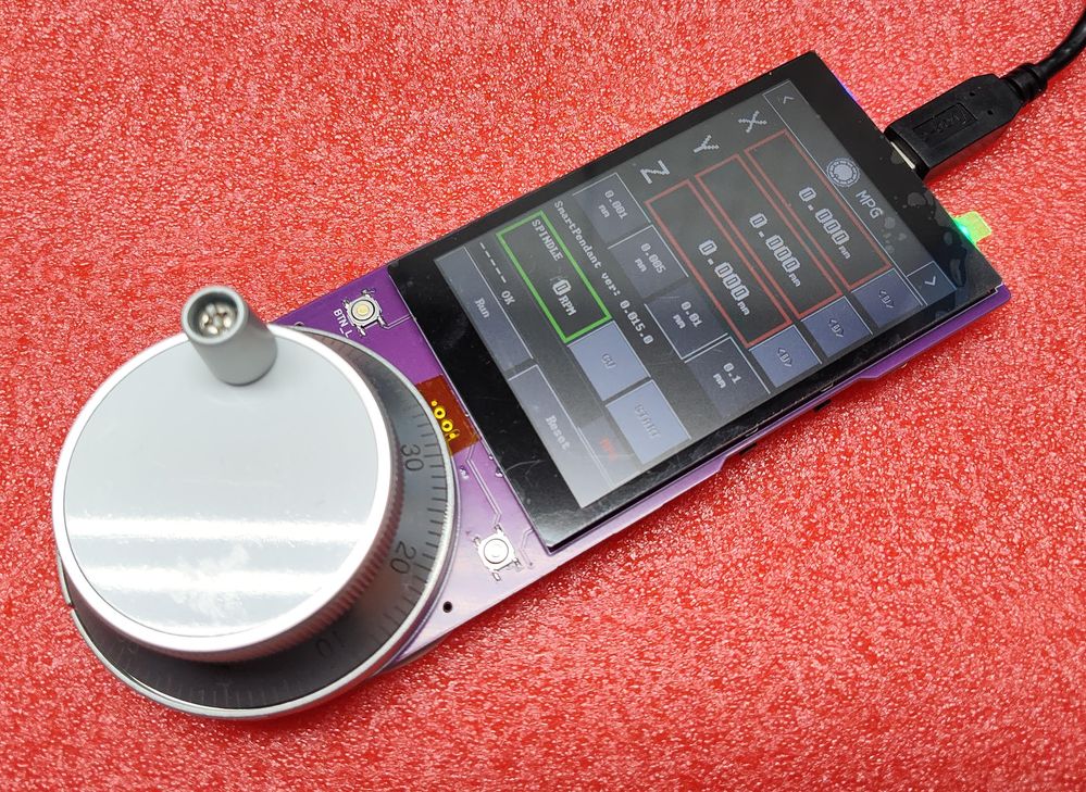

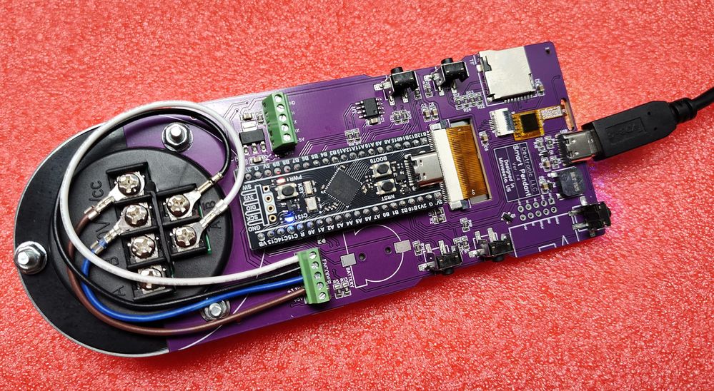

I really want this issue to be fixed, because I can't use those boards for my SmartPendant project to control CNC machines based on grblHAL controllers, since it will be impossible to update firmware under Windows 10, and even worse - attempt bricks device until it will be reprogrammed on Windows 11.

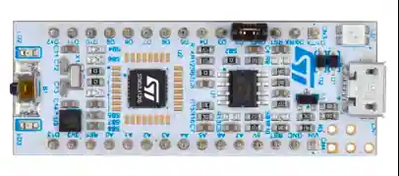

As for using Nucleo... how I suppose to fit it inside device on photos I posted? Rhetorical question.
Use a Nucleo 32?
https://www.st.com/en/evaluation-tools/stm32-nucleo-boards/products.html?querycriteria=productId=LN1847$$1574=Nucleo-32
To be honest as ST we don't support these * Pill boards for the reason I mentionned previously. Maybe you need to unsolder and solder another Genuine chip purchased from trusted distributer like mouser, arrow etc..
Of course, the NUCLEO have sometimes a different form factor, but they may not be used in end products (see Terms of Use, Restrictions and Warnings). A NUCLEO is therefore only intended for the development phase in the laboratory and is usually replaced later by a separate layout.
If you then obtain the MCUs from trustworthy sources (dealers such as Aliexpress are not among them), you will already have a lot fewer potential problems.
@Peter BENSCH wrote:
A NUCLEO is therefore only intended for the development phase in the laboratory and is usually replaced later by a separate layout..
Indeed.
It seems that @Shlapunov.Nicolai has the PCB design resources - so why not just put the SMT32 straight onto the PCB? Why the plug-in board at all?
