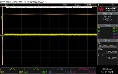

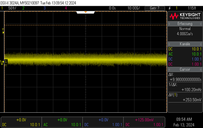

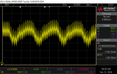

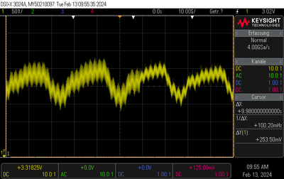

i like the idea, to measure the voltage of the pin, when it is configured as output, for checking the internal power rail of the GPIO Peripheral.
Compare GPIO driven LOW - without and with FMC-Active:

Compare GPIO driven HIGH - without and with FMC-Active:

noise is in both cases definitely more than nothing. The 3V3-supply-ripple, the noise on the pin and the noise on the power-rails in sum is with sure not that far away from the 200mV Hysteresis of the GPIO-Pin. Most of the noise effects the chip internally, so i think, with better filtering, or better layout you can't reach a really safe design with this mcu as long as the schmitt trigger hysteresis is that low.

Hi @AZorn.1 ,
I see about 10mVss + 50mVss with FMC on gnd ; i am little bit surprised - i expected more. :)

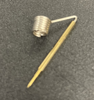

Just to make sure:
scope measurements are done without the ~10cm GND clip, but with the ground / spring / tip directly besides the "hot" contact?
2024-02-13 3:50 AM
@LCEyes, with the spring-tip, to have GND loop as small as possible.
:thumbs_up:
2024-02-13 4:30 AM
Ah, spring-tip is the official name? Never used that in english... :grinning_face_with_sweat:

2024-02-13 8:38 AM - edited 2024-02-13 8:39 AM
sorry for my partially google-translated way of writing here.
What would you name this item:
2024-02-13 8:43 AM
I was rather laughing about myself, I think "spring-tip" is pretty good.
I would call it "Probe-Kontakt-Feder", beautiful "Denglisch". ;)
