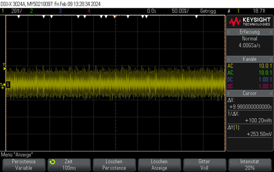

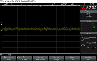

thank you for your valuable input. Crosstalk from other pins was also one of my attempts so i used my (of course not the fastest one) to inspect the problem-trace.
Coupling was AC to filter the DC-part and to bring the signal down to GND, for better scoping. GND-Spring to have lowest possible GND-Loop (only few mm) to reduce extra noise due to the scope probe. And i scoped the via, directly near to the BGA, not to miss anything.
first one is without FMC-communication
second one with running FMC-communication (Be careful, it looks worse than it is due to the "Persistance-overlay" view of the scope.)
so, of course the noise level rises, but all within +/-20mV compared to the 200mV pin-hysteresis, i would say, this can not be the cause. It should be an easy one for the Schmitt trigger to filter this small noise.

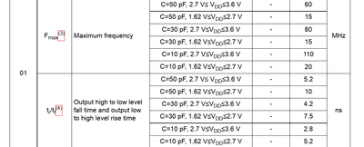

--> Try : setting all FMC outputs/pins to medium or low drive speed, depends on your speed for FMC, try little bit low speed , to prove this.
btw
the medium setting still can work up to 80...100MHz :
2024-02-12 8:01 AM
Hi AScha.3,
thank you for your suggestion.
I gave it a chance and tested the com with 12.5Mhz (instead of 133MHz) with EVERY pin in lowest speed mode.
Same behavior, but with lower speed on RAM access. Lot's of additional and unwanted pin-changes.
Maybe the lines coming from RAM still produces the noise because i can't configure driver strength on the external chip.

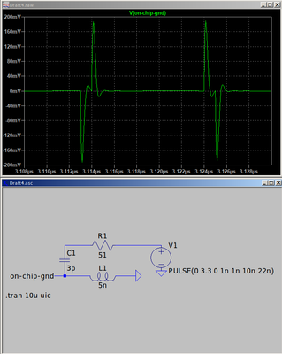

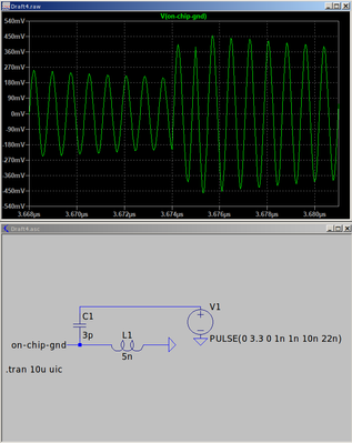

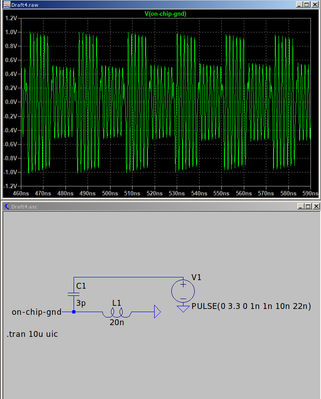

just for fun:
simu, what will be internal gnd bounce, at 3pF pin capacity and about 20mm from chip to gnd (= about 20nH line)
surprise, surprise : at 1ns rise/fall times you might get +/- 1V spikes...sure enough to trigger 200mV sm levels.
(= thats external 1ns rise/fall driving the 3pF pin capacity... )
Now if you optimize layout..and get real distance chip-gnd to 5mm -- 5nH :
-> stll 450mV spikes
Now 5mm with 51 r in line :
yepp. 200mV max spike.
