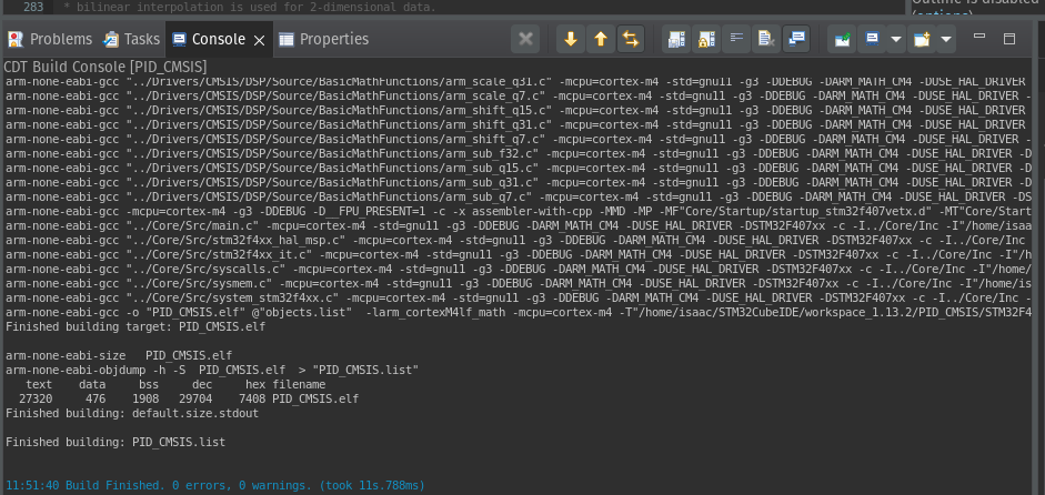

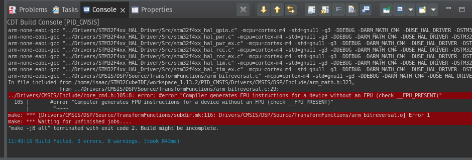

While replicating the method of integrating DSP libraries into my STM32 project as discussed in the following thread: tutorial , I encountered the error #error "Compiler generates FPU instructions for a device without an FPU (check __FPU_PRESENT)" during the project compilation. I'd like to share a solution that proved effective in resolving this issue.

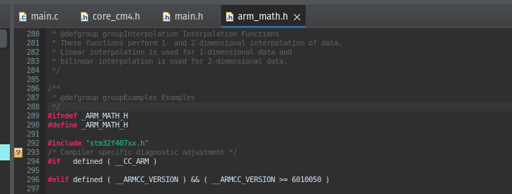

Upon inspecting the "arm_math.h" file, I observed that, after the preprocessor directives, there is an inclusion of the header file containing information related to the device's peripheral access layer, in my case, "stm32f407xx.h". The solution involved simply moving the `#include "stm32f407xx.h"` directive to the beginning of the "arm_math.h" file. Following this modification and performing a clean build of the project, the error disappeared.

Error
moving include
result

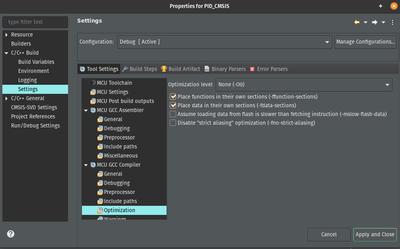

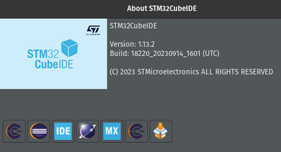

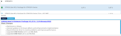

Thank you for welcome. Below, I'll provide screenshots containing the information about the versions I'm using. If needed, I can supply additional images.
Best regards,
[Isaac Vinicius]
STM32CubeIDE version:
STM32CubeF4 revision:
Level of optimization (Default):
