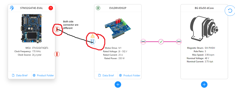

Hi ST Team,
I'm creating project in the motor control workbench,
I had selected hardwars are
1. STM32G4EVAL1 Board
2. Motor Drive
3. Motor
once i selected in the tool as shown in below.
in this connector are not available to connect to the main board to motor drive.
need to import the .Json file but in portal there is .Json file.
2026-03-29 6:17 PM
X-NUCLEO-IHM09M2 is dedicated connector for the morpho, you can refer the Nucleo board NUCLEO-G474RE.
STM32G4-EVAL1 Board don't have the right connectors for X-NUCLEO-IHM09M2.
2026-03-29 6:23 PM
Which connector is best for the STM32G4-EVAL1 to EVALDRIVE102P,
Could you suggest any part number in the hardware list or custom connector need to create(.JSON) from the tool.
2026-04-01 9:01 AM
Hello @VINODC,
X-NUCLEO-IHM09M2 is already available on MCSDK tool (MC_SDK_6.x.x\Utilities\PC_Software\STMCWB\assets\hardware\board\adapter directory).
This configuration needs a modified X-NUCLEO-IHM09M1 adapter board as provided in this post.
