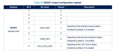

Generating a project with MCSDK on EVSPIN32G4 board, refer to "STSPIN32G4 driver component initialization" firmware part in MCboot() function, and to STSPIN32G4 datasheet for register description.

Also, is the current issue related to UVLO (Under Voltage Lockout)?
