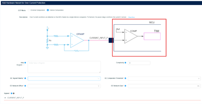

The graphical representation shows an internal op-amp amplifying the signal entering the comparator's positive input.
However, the STSPIN32G4 positive input comparator cannot be an op-amp output unfortunately and is limited to op-amp positive inputs - see Ref. Manual RM0440 ver 9 (Figure 168).
This is misleading, because only non-amplified signals gets to the positive input of the comparator.

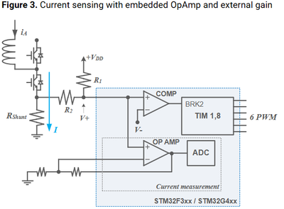

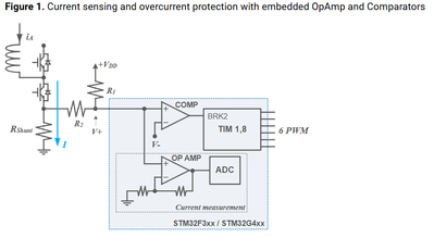

The Motor Control Workbench User's Manual is correct with the proper graphical representation.
STM32 Motor Control SDK: Current sensing and protection using embedded OpAmps and Comparators
Importantly, the op-amp output cannot be used for over-current sensing because during power up and reset they are not operational. As a result, if using an op-amp output and there is a short happening during power-up or reset, the over-current protection will be disabled during those transient times.

In Board Designer overcurrent protection internal comparator OCP mode, the MCU is limited to the area indicated by the red square. In the description, OPAMP refers to the external gain value and does not indicate the use of an internal OpAmp Ip.

Hello ,
The graphical representation is misleading - the selection of the internal op-amp must follow the correct representation with the positive input connected to the outside pin selected.
To say that only a part of this graphical representation is valid is ludicrous - when the output of an op-amp is connected graphically.
This is so confusing for the person who start a custom board design and may lead to incorrect choices.
