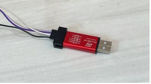

Thank you very much for continued support. Please confirm me the below two points then i can proceed accordingly.
a. I have the below STLink V2 dongle
I am able to flash the code but facing some reset issues, which i need to look into. Could you please confirm if i can do my development with this, without worrying about the onboard STLink firmware which got erased.
b. Do i need to buy a new board of STSPIN3201?
Please confirm which method is the best.
