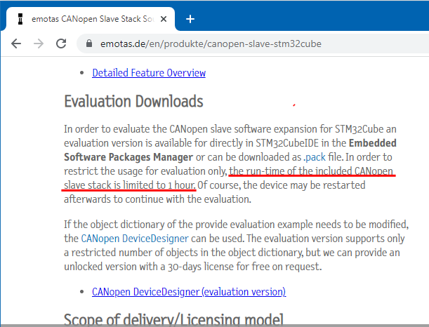

@Dldw.1 "after running for a period of time, a message indicating hardware failure is displayed"
Would that "period of time" happen to be 1 hour, by any chance ... ?

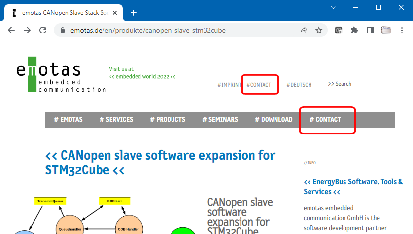

2022-06-09 1:56 AM
Go on - there's two 'Contact' links at the top of the page::
(might be spelled the German way - "Kontakt")
