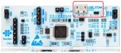

And you are using the built-in debugger on the Nucleo board itself - via CN2 - yes?
In that case, you (or somebody before you) must have converted that ST-Link to a J-Link using Segger's converter:
https://www.segger.com/products/debug-probes/j-link/models/other-j-links/st-link-on-board/
You can use that same converter to reverse the process: Restore ST-Link Firmware.
