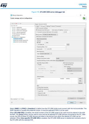

I got this (since I have multiple STLINKs attached):
Where do I specify the serial number in the command line (of the gdb server) ?

Hello @chriskuku
to select a specific ST-Link will connecting multiple ST-Link to your machine, you have to follow the last paragraph of the page 160 of the UM2609 together with the figure 176:
Best Reagrds.

2025-09-14 12:42 AM
Thanks. I see this configuration option in the ST-LINK(ST-LINK GDB server) setup but not in the ST-LINK (OpenOCD).
2025-09-14 1:03 AM
This option is not available in openOCD debug probe.
