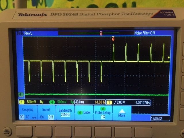

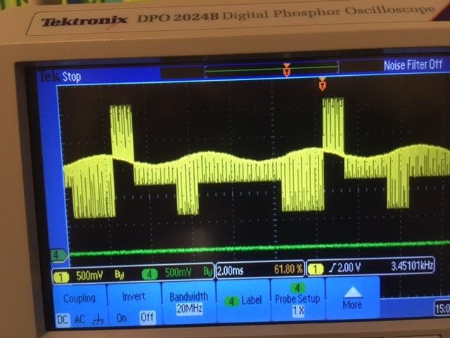

Adding to this question, in mc_tasks.c in procedure __weak uint8_t TSK_HighFrequencyTask(void) I added the following: (value is declared static uint32_t (near line #736):
/* USER CODE BEGIN HighFrequencyTask SINGLEDRIVE_3 */
value = STO_PLL_GetEstimatedBemfLevel( (&STO_PLL_M1) );
HAL_DAC_SetValue( &hdac1, (uint32_t) DAC_CHANNEL_2, (uint32_t) DAC_ALIGN_12B_R, (uint32_t) value);
/* USER CODE END HighFrequencyTask SINGLEDRIVE_3 */My setup of DAC1_CH2 in MX_Dac1_Init is the following:
/** DAC channel OUT2 config
sConfig.DAC_Trigger = DAC_TRIGGER_NONE;
sConfig.DAC_ConnectOnChipPeripheral = DAC_CHIPCONNECT_EXTERNAL;
sConfig.DAC_SampleAndHold = DAC_SAMPLEANDHOLD_ENABLE;
if (HAL_DAC_ConfigChannel(&hdac1, &sConfig, DAC_CHANNEL_2) != HAL_OK)
Error_Handler();
}The actual DAC output 'resembles' what I expect (a 0.5V sinewave at 200Hz) but it has spikes every period of the motor PWM frequency.
I don't know if the value I'm retrieving is wrong or if my use of the DAC for output is wrong.

On question [3] I did find that the MxCube generated code already was calling UI_DACUpdate(TSK_HighFrequencyTask()); in stm32f03x_mc_it.c, so at least one DAC was being called twice in one interrupt period. I've been able to fix that. No spikes, it's a nice clean sinewave 6x per revolution on a 6 pole-pair motor.
